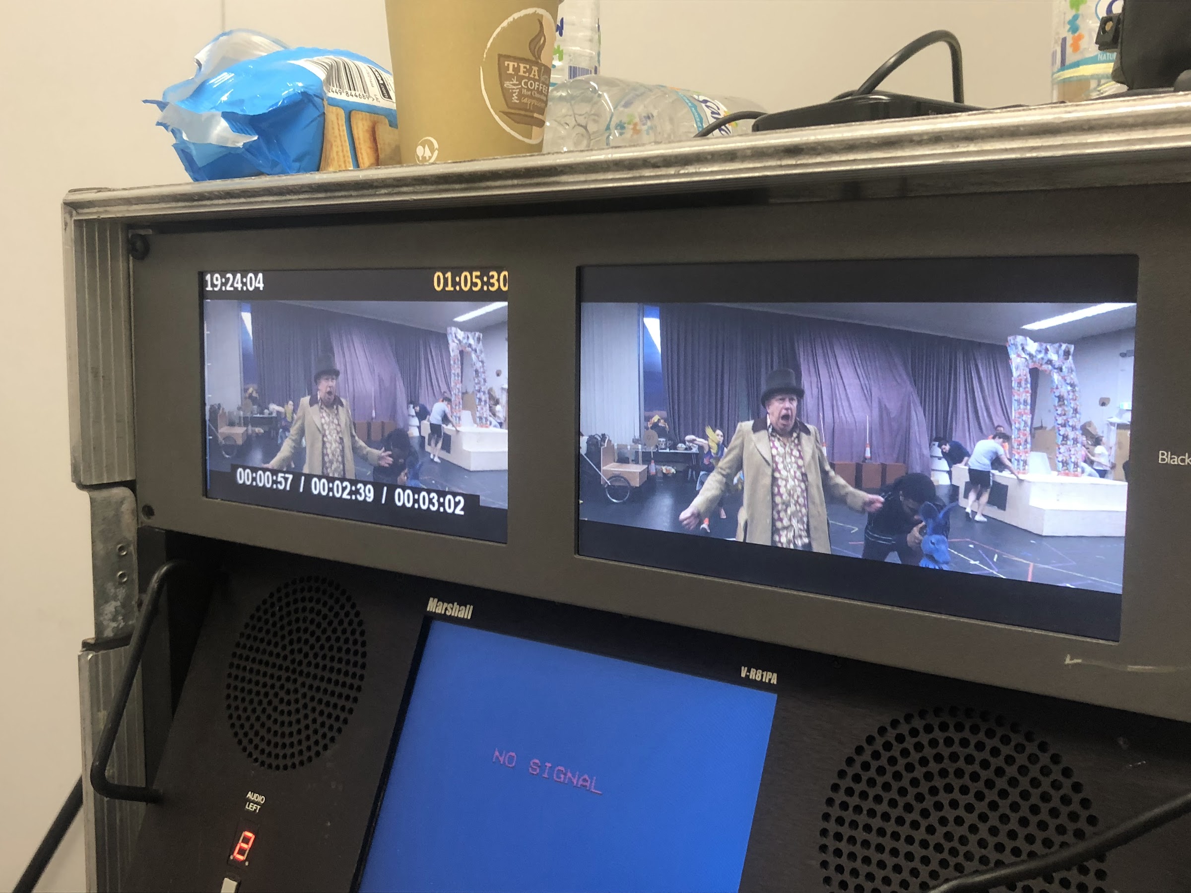

I often have to do this for events and my approach is almost the same.
First, use desktop capture to get the VT clock and also create an input from the Production clocks.
Then I create an empty input using the color input set to transparent then crop and layout things as needed
I then set overlay channel 4 to only display on output 4 that is set up as an NDI output.
then i put my "clocks" input that I have built in overlay 4 and leave it there
the output of this is then displayed as needed using NDI Studio monitor wherever needed as shown below
Clocks
yes I would be nice if we could access the VT Clock without messing with screen capture
