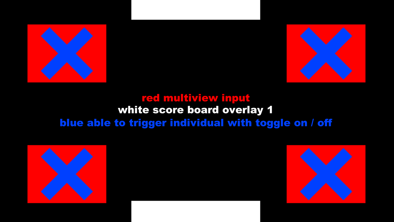

I have the following setup.
Input is composed of a Multiview that has cam and graphics on the input, I build it color, then the Multiview layers, cam, graphics.
I use a overlay 1 to display a scoreboard over the Multiview input.
Now i would like to accomplish the following -> I have 4 players and each of them could die off in the round, I would like to trigger a big X over the Multiview per player which are in each corner of the screen, since i only have 3 overlays left what could i do?
The X should be able to be triggered via a stream deck toggle button
[img=https://postimg.cc/G81T3XVK]setup[/img]
https://i.postimg.cc/bJZxTMR7/setup.png

Assuming the player inputs are separate before put in the multiview ...
add a layer with the X on each of the player's input and use shortcut to turn these layers on/off ( or if you have four layers left in the multiview ...)

how would i trigger the layer in the multiview via a short cut?
Got it working in the shortcut menu, worked like a charm.
Thank you!

MultiviewOverlay shortcut: Toggle On/Off MultiView Overlay For Input At Index (starting from 1)
The helpfiles (other name for Manual) do have a Shortcut function reference list !
