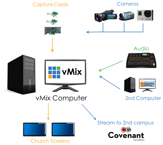

We do what you are talking about but we use two computers. One is a Mac that does the slides/images to the projectors, the other is a custom PC dedicated to vMix.
The vMix computer has a capture card for the cameras as well as the slides (HDMI splitter from mac to projector and vMix computer). This computer records the services and now live streams to Facebook.
We have found this to work extremely well.
There is one more layer that allows us to put the vMix output on the screens if we want. We added an HDMI matrix right before the projectors. This way we can easily pick which computer feeds the screens.
The diagram for our setup is almost exactly like the one on the vMix website under Solutions/Churches. The direct link to the image is:
http://www.vmix.com/images/solutions/churches/covenant-church-set-up.png
Hope this helps.
