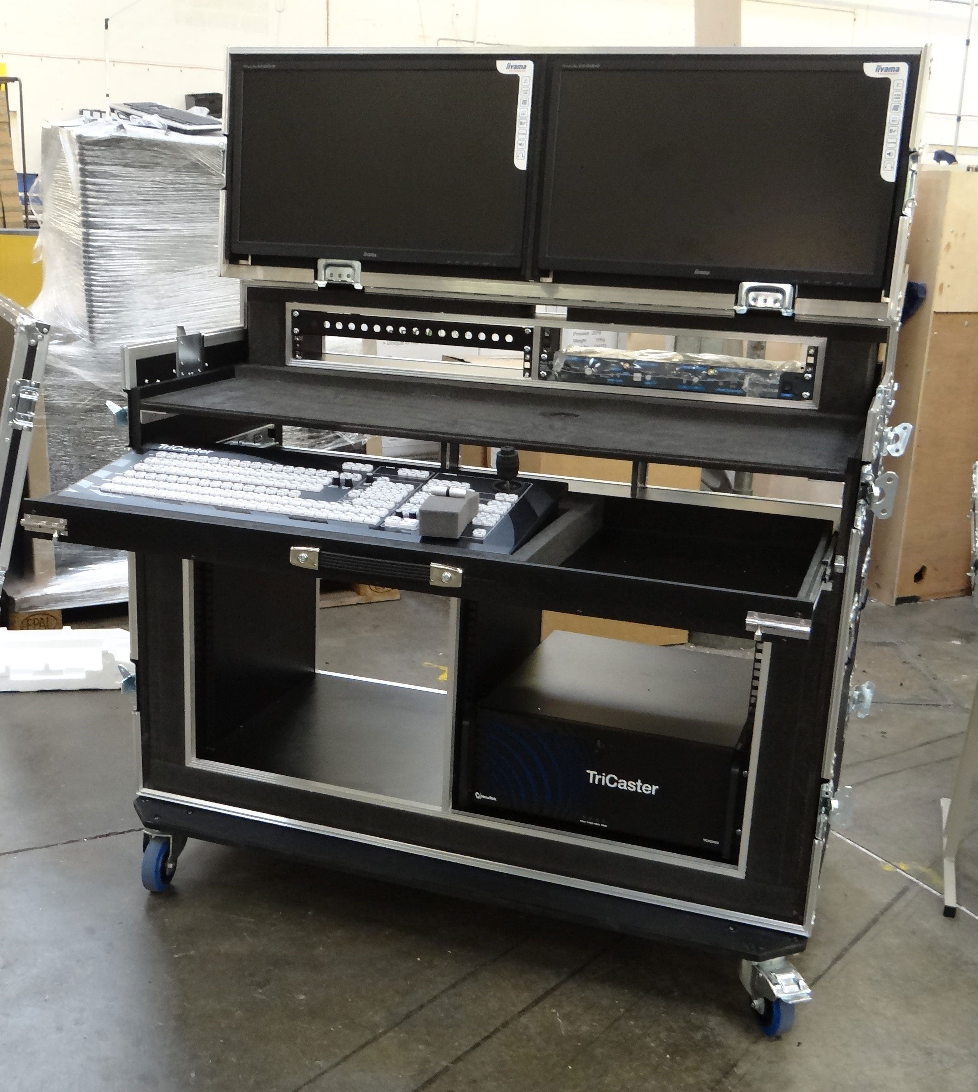

I will also build a flight case for the PC and other equipment plus 2 screen. somthing like this

For those thinking of building their own flight cases.
Found this great supplier for all case parts...
http://www.tchweb.com/tchstore/category/case/s0/Case-Hardware.html
Case look very similar to the TC2GO Airpack 2 from VideoLink
http://www.videolink.ca/videolink-clydesdale-cases/Air-Pack-2-VideoLink-2016.jpg
I will be building my own version similar to the TC2GO Airpack 2 from VideoLink...
