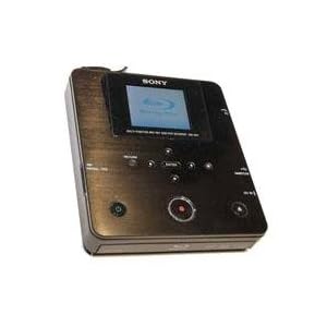

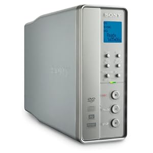

ELCHAPIN!
Hi!!! In an old post you mentioned that you found a VGA conversor... can you post a link to see it?
Its something like that?
Regards!
