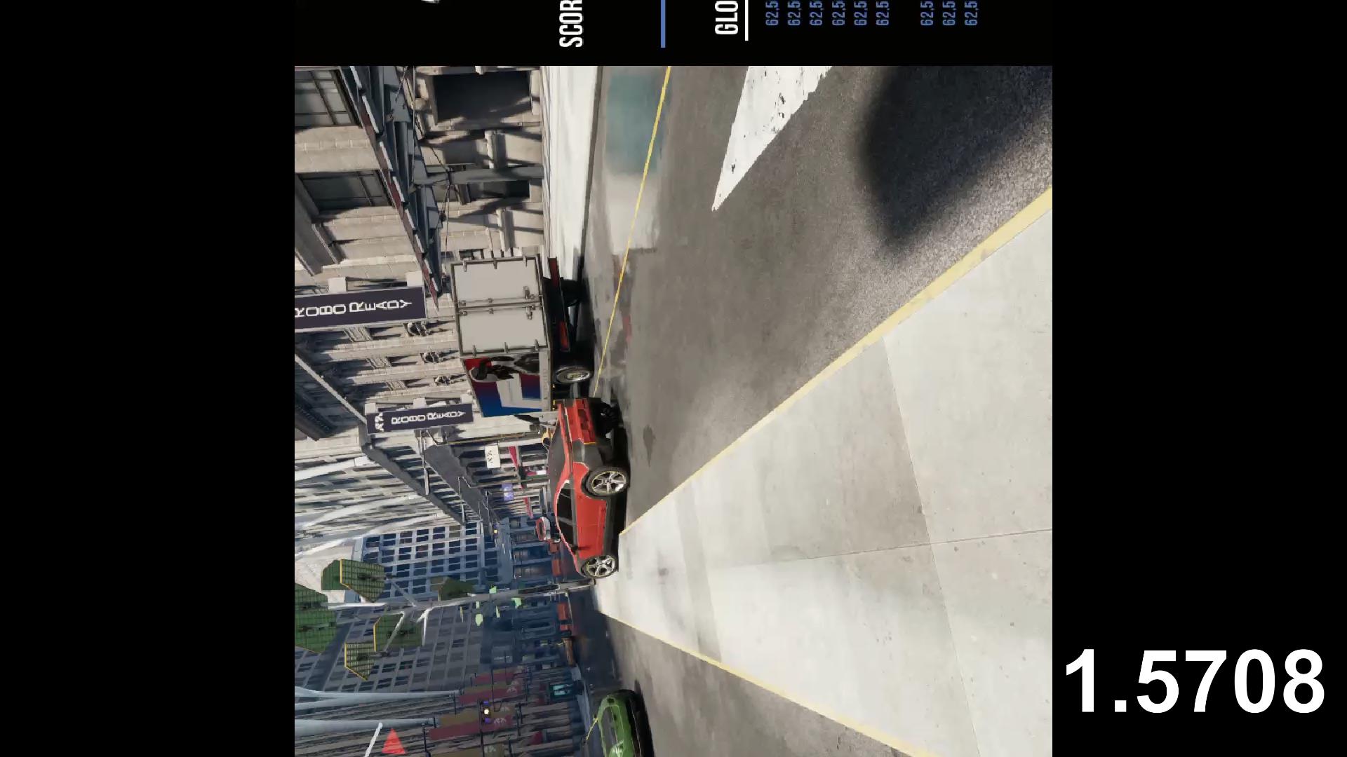

Here is a calculator for the values Thanks to Dave Edwards over at the FB Streaming Idiots Group for his help with this.
http://www.rapidtables.c...-radians.htm?x=90&y=
1.5708 radians, 2 radians equals 360 degrees. This means that 1 radian = 180 degrees
180 = Pi 270 = 4.7123889804 - I think that is the issue I am having is that these numbers are irrational.
90 degrees is easy to type and fast. That is one of the things I love about vMix is how fast it is.

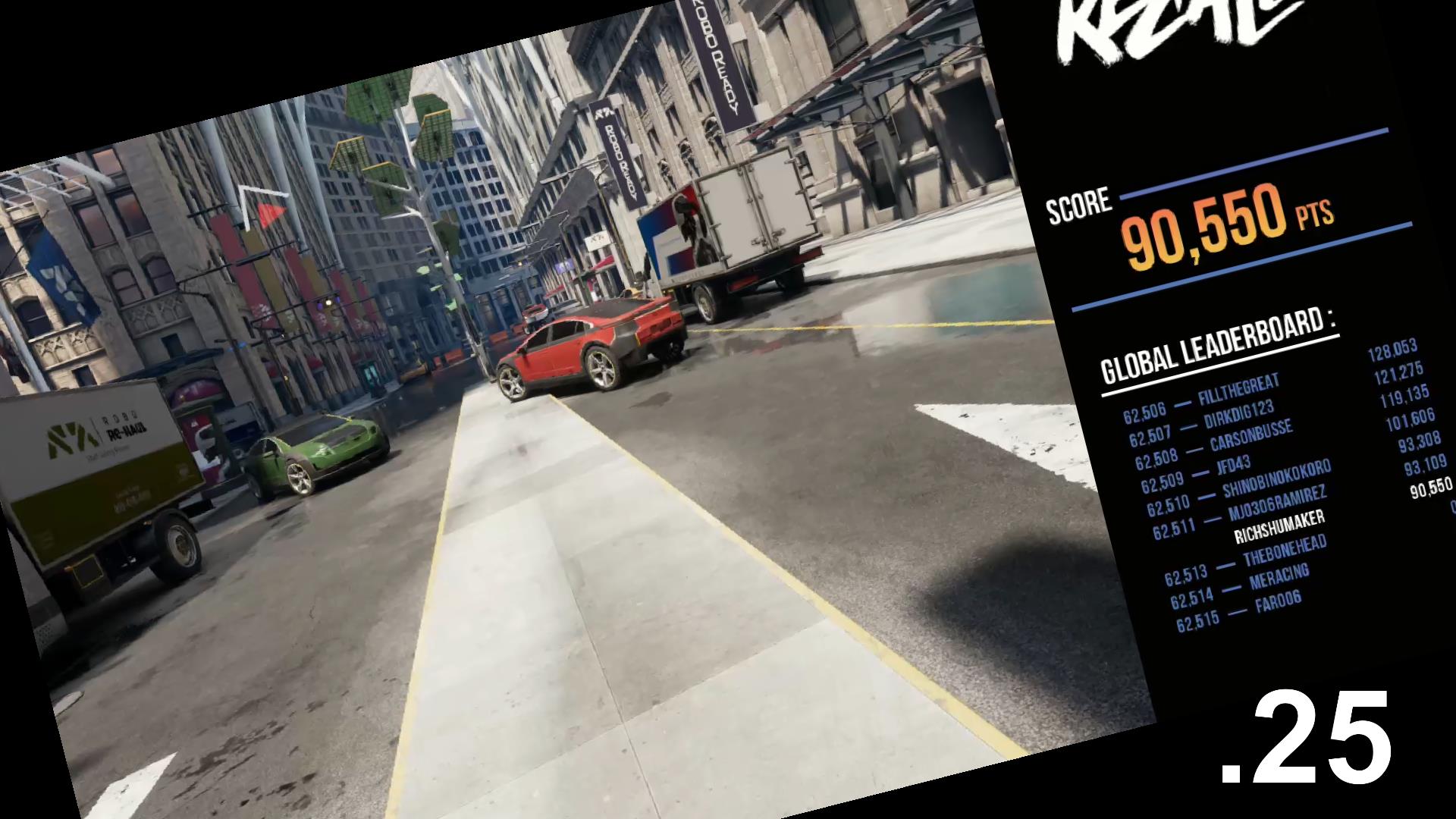

Someone said .25
http://www.richshumaker.com/img/90degreeturn.jpg[/img
Here is 90 degrees 1.5708
http://www.richshumaker..../90degreesindecimals.jpg[/img
